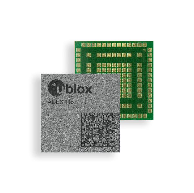

u-blox, a global provider of leading positioning and wireless communication technologies and services, has announced the ALEX-R5, a miniature cellular module that integrates low power wide area (LPWA) connectivity and global navigation satellite system (GNSS) technology into an ultra-small system-in-package (SiP) form factor. Comprising hardware components designed fully in-house, ALEX-R5 is based on the secure UBX-R5 LTE-M / NB-IoT chipset platform with out-of-the-box Secure Cloud functionality and the u-blox M8 GNSS chip for world-class location accuracy.
ALEX-R5 stands out for its miniature 14×14 mm footprint, achieved thanks to its SiP design, reducing its size compared to the functionally equivalent u-blox SARA-R5 module by half. Its tiny dimensions make it a perfect fit for size constrained applications.
