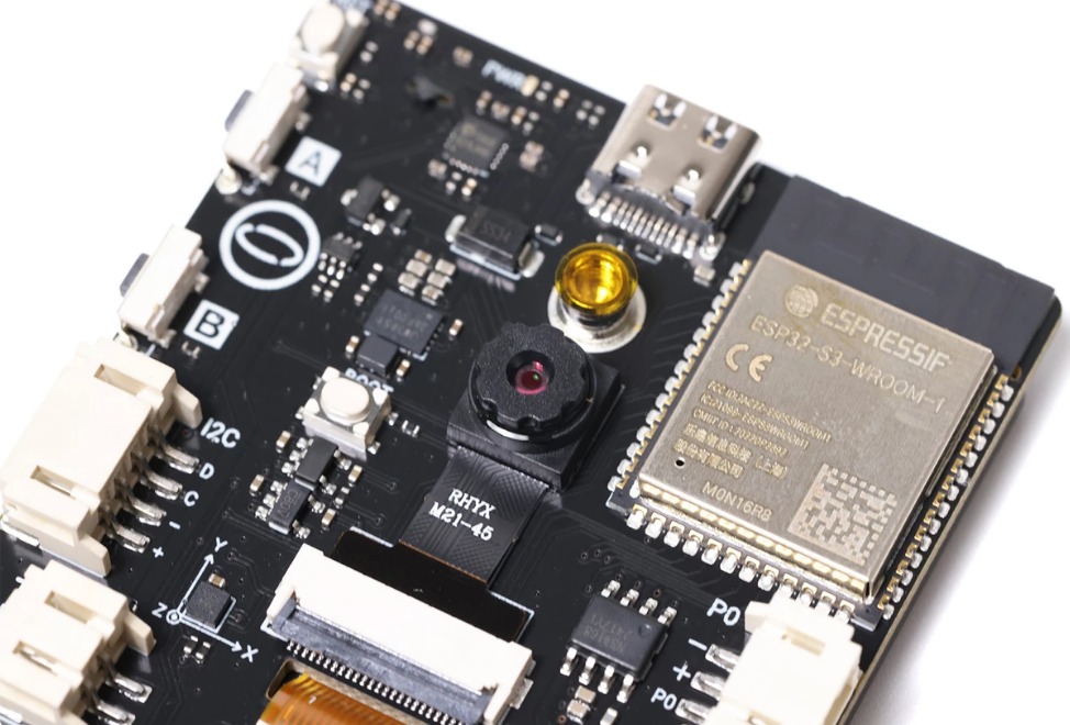

UNIHIKER K10 specifications:
  • Core Module: ESP32-S3-WROOM-1
    • Processor: ESP32-S3N16R8 dual-core Tensilica LX7 @ up to 240 MHz with 512KB SRAM, 8MB PSRAM, and 16MB flash
    • Wireless Connectivity:
      • Wi-Fi 4
      • Bluetooth 5.0 / BLE
      • PCB antenna
  • Storage: MicroSD card slot
  • Display: 2.8-inch 240 x 320 color LCD (ILI9341 driver)
  • Camera: 2MP camera with 80°FOV (GC2145 sensor)
  • Audio: 2W speaker and 2x MEMS microphones
  • USB: 1x USB-C port for power and programming
  • Sensors:
    • AHT20 temperature (-40 to 85°C) and humidity (0 to 100% RH) sensor
    • LTR303ALS ambient light sensor (up to 64k Lux)
    • SC7A20H accelerometer
    • 2x MEMS microphones
  • Expansion:
    • 3-pin Gravity connector (2x GPIO)
    • 4-pin Gravity I2C connector
    • Edge connector:
      • 3x GPIO (banana clip)
      • 15x Digital IO
      • 1x I2C
      • 3.3V and GND
  • Misc.:
    • A, B, RST, and BOOT buttons
    • 3x WS2812 RGB LEDs
  • Power Supply:
    • 5V via USB Type-C
    • 3.3V via edge connector
    • 2-pin battery connector
  • Dimensions: 51.6mm x 83mm x 11mm
