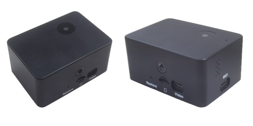

Vantron has recently launched the HCAM26 Wi-Fi Camera, a high-definition security camera designed for long-range security uses like in remote areas, isolated plants, and smart homes. It uses the sub-1GHz IEEE 802.11ah Wi-Fi HaLow standard for long-range connectivity, supporting up to 1 km of transmission distance with strong wall penetration capabilities. Key features include 4K (2592 x 1944) video output, 5.0-megapixel high-resolution resolution, two-way audio communication, local storage via a Micro SD slot, and ultra-low power consumption with a 2600mAh Li-ion battery. The camera is powered by a quad-core ARM Cortex-A7 processor, RISC-V MCU with AI capabilities supported by a 2.0 TOPS NPU, H.265/H.264 video codecs support, and offers connectivity options like USB Type-C and Micro HDMI.
This camera is approved by FCC and TELEC, so it’s safe to use in the US and Japan. It is suitable for use in remote places, smart homes, factories, and other spots where you need a dependable and low-power efficient security camera.

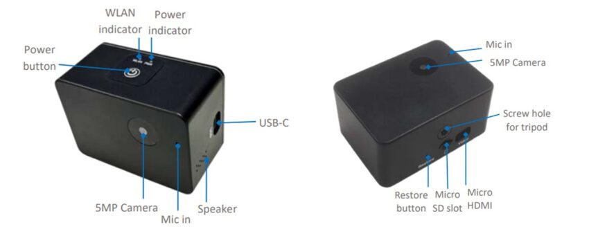

Vantron HCAM26 Wi-Fi Camera Specifications:
  • Processor: Quad-core ARM Cortex-A7 32-bit vision processor
  • MCU: RISC-V MCU
  • AI: 2.0 TOPS NPU, supports INT8/INT16
  • Memory: 1GB DDR4
  • Storage: 8GB eMMC, 1 x Micro SD slot (for storage expansion)
  • Camera:
    • 5 MP 1/4″ CMOS image sensor
    • Resolution: 2592 x 1944 (QSXGA)
    • Output: 8-/10-bit RGB RAW
    • Frame Rate: VGA @ 30fps, QVGA @ 60fps, QQCIF @ 120fps
    • Lens: 6P construction, F2.4 aperture, 73.9° (V) FOV, 92.4° (H) FOV, 119.9° (D) FOV
    • Focal Length: EFL 1.785mm, BFL 0.934mm
  • Video Encoding:
    • ISP: Max. 14MP
    • Codec: H.265/H.264
    • Frame Rate:
      • 3840 x 2160 @ 30fps + 1080p @ 30fps
      • 3840 x 2160 @ 30fps decoding
  • Wi-Fi:
    • Standard: IEEE 802.11ah (Wi-Fi HaLow)
    • Mode: Station
    • Frequency: US 902-928MHz, JP 916.5-927.5MHz
    • Security: WPA3, AES, SHA1, SHA2
  • Audio: 1 x Mic input, 1 x 1W speaker, two-way audio
  • I/O Ports:
    • 1 x USB Type-C
    • 1 x Micro HDMI (up to 4K @ 30Hz, no sound output)
  • Buttons: 1 x Power button, 1 x Restore button (reboot/factory reset)
  • LED Indicators: Power, Wi-Fi HaLow connectivity
  • Operating System: Linux Yocto (support by request)
  • Environment:
    • Operating Temperature: -10°C to +50°C
    • Storage Temperature: -20°C to +70°C
    • Humidity: 5% to 95% RH (non-condensing)
  • Certifications: FCC, TELEC
  • Power:
    • Input: 5V/2A DC via USB Type-C
    • Consumption: Active: 198mW; Standby: 35μW; Average: <3W
    • Battery: 2600mAh Li-ion, up to 4 hours operation
  • Dimensions: 91.6mm x 65mm x 47.2mm
The camera comes with Yocto-based Linux software that you can use to control it and watch the videos on your phone. You’ll also need a special router called a HaLow access point to connect the camera to your Wi-Fi. There are different options for this, like the Vantron HAP101 or HAP103, or other brands like AsiaRF. You can also add a HaLow USB adapter, mini PCIe module, or Raspberry Pi HAT to your computer to make it work with the camera.
