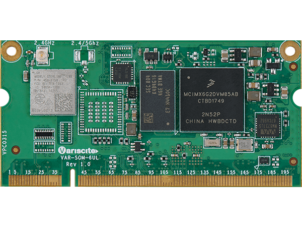

Variscite announced the launch of the VAR-SOM-6UL System on Module. The VAR-SOM-6UL powered by NXP’s i.MX 6UltraLite / 6ULL / 6ULZ ARM Cortex-A7 processor with up to 900MHz CPU Clock. The new SoM is based on Variscite’s popular DART-6UL platform while integrating additional LVDS bridge option, all packed in SO-DIMM200 form factor to fit the VAR-SOM Pin2Pin family. The expansion of the Pin2Pin family provides full scalability to Variscite’s customers.
The VAR-SOM-6UL is a highly integrated SoM, optimized for power, size, and cost. The design is based on the popular DART-6UL platforms and supports all the features and connectivity options, including dual Ethernet, dual USB, audio, CAN Bus, camera in, Bluetooth/BLE, Touch, ADC, PWM, as well as support for industrial temperature grades -40 to 85°C. In addition, the VAR-SOM-6UL has been enhanced with LVDS bridge via SoM and on SoM two certified Wi-Fi configuration – single-band 802.11b/g/n or dual-band Wi-Fi 802.11ac/a/b/g/n.

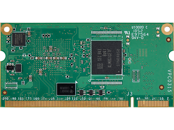

VAR-SOM-6UL bottom view

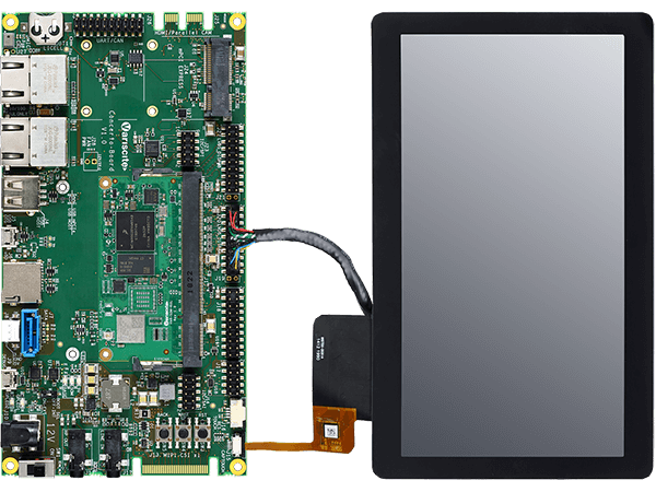

VAR-SOM-6UL Development Kit

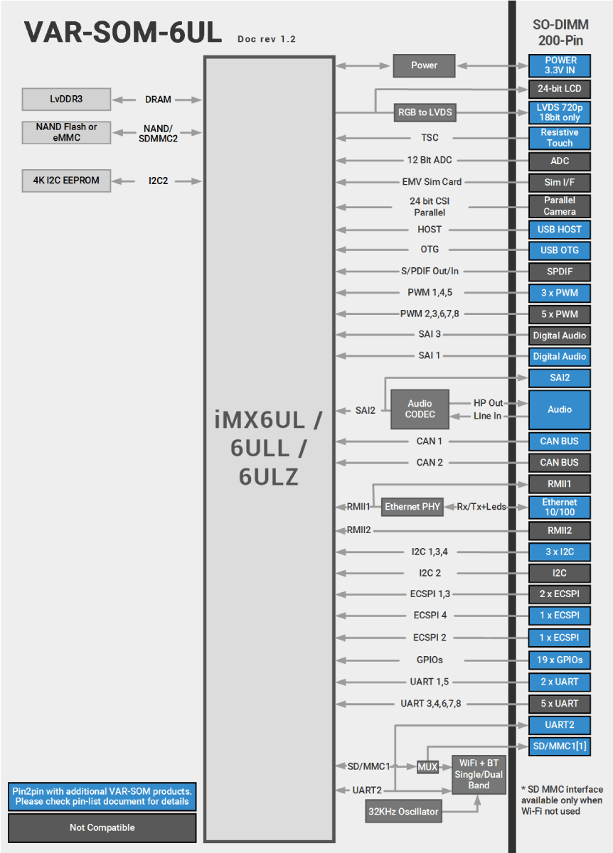

VAR-SOM-6UL Block Diagram
