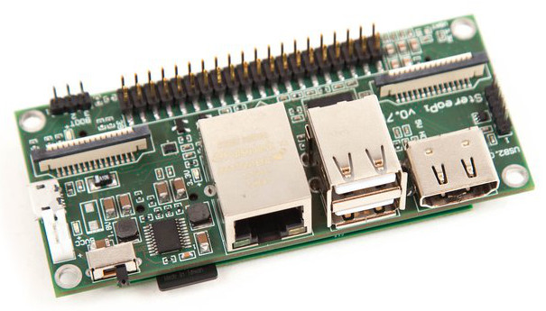

Virt2real has launched its camera kit designed to function with an RPi Compute Module and 2x Raspberry Pi cameras. It moves from the original CM1 to the latest CM3+ for additional performance and compatibility. The camera board supports spatial awareness, 3D depth maps, and 3D video live streaming, among others. The StereoPi can be used for capturing, saving, live-streaming, and processing real-time stereoscopic video and images for robotics, AR/VR, computer vision, drone instrumentation, and panoramic video.
On Crowd Supply, the StereoPi is available in a Standard version for $89, and a $69 Slim model with a shorter 15mm build. The shorter build eliminates the real-world connectors for 10/100 Ethernet and 2x USB 2.0 ports and supplies the board a 40-pin GPIO connector. Both packages are void of the Raspberry Pi CM3, cameras, camera ribbon cables, or power and USB cables. A $125 Starter Kit is also available based on the Standard model.
![](https://www.electronics-lab.com/wp-content/uploads/2019/02/virt2real_stereopi.jpg)
The Starter Kit has a second power cable and also a microSD card with the StereoPi Raspbian image and demos. Available also is a Deluxe Kit with dual wide-angle (160°) cameras. Additional accessories Kit for $25, offers 5cm cables for connecting the cameras to the StereoPi board. This substitutes the 10-20cm cables that are available for the V1 and V2 cameras. A USB, standard power cables, and two acrylic plates for mounting both standard and wide-angle cameras are available in the kit. The 90 x 40 x 23mm StereoPi board is fitted with LAN and dual USB ports, and also a micro-USB port for power and a USB header.
![](https://www.electronics-lab.com/wp-content/uploads/2019/02/virt2real_stereopi_detail.jpg)
The board features an HDMI output port, a microSD slot, a 5VDC input, a manual power switch, and a 40-pin GPIO connector for Raspberry Pi I/O. The StereoPi image supports Python and example code. It also supports micro-USB delivered firmware updates. The board offers dual MIPI-CSI-2 camera connectors that support either the Raspberry Pi V1 or V2 cameras, and also Auvidea’s B101 HDMI to CSI-2 bridge module with HDMI input port. The camera connectors also support the optional wide-angle camera (5-megapixel Waveshare RPi Camera G).
