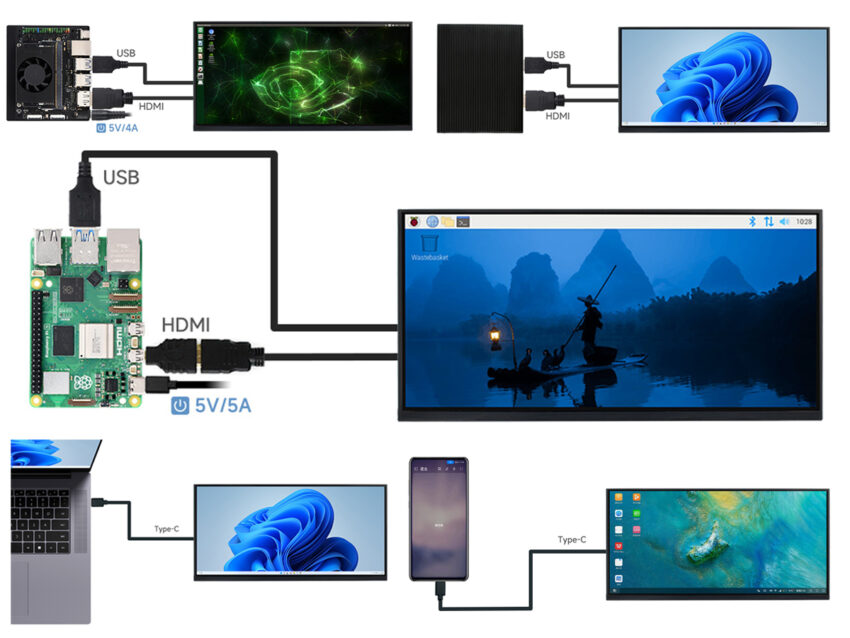

Waveshare has recently launched an 11.6-inch Capacitive Touch Display with in-cell technology, a 1768×828 resolution, and a 178° wide viewing angle. This screen uses an IPS (In-Plane Switching) panel for great colors and a clear picture. And then it supports HDMI and Type-C display interfaces to connect with other devices. The display is ideal for use with Raspberry Pi, Jetson series, PCs, and smartphones, offering multi-point touch functionality—up to 10 points, depending on the device’s operating system. It has a full-featured Type-C interface that supports audio and video transmission.

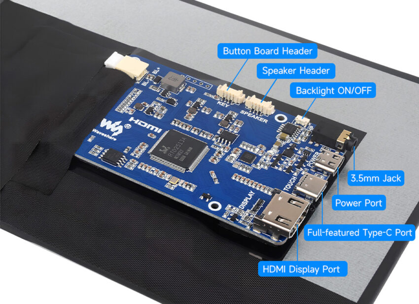

    • Display Interface: HDMI, Type-C
    • Touch Interface: USB Type-C
    • USB Type-c port for power input
    • Backlight ON/OFF switch
  • Audio:
    • 3.5mm jack for audio output 1
    • 4-pin header for audio output 2
  • OS Support:
    • Raspberry Pi OS, Ubuntu, Kali, Windows 10 IoT (10-point touch)
    • Windows 7/8/8.1/10/11 (10-point touch)
    • Ubuntu for Jetson Nano/TX2/Xavier NX/Orin (single-point touch)
    • Retropie (driver-free)
    • Smartphones with full-featured Type-C interface (e.g., Huawei, Samsung, OPPO)

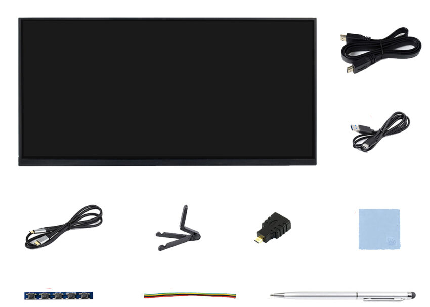

Lastly, the package includes an 11.6-inch 1768×828 LCD, a 1-meter HDMI flat cable, a 1-meter USB-A to Type-C cable, a Type-C dual-plug cable, a Triangular stand, HDMI to Micro HDMI adapter, a Cleaning cloth, a Button board, a 1.27H 4PIN button board cable, and a Capacitive touch pen for easy setup. For further information like features, parameters and more, you have to visit the product wiki page.
