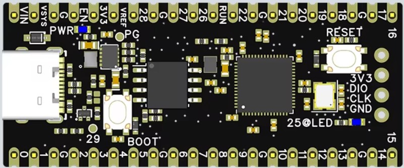

The WeAct Studio RP2350A_V20 is an affordable microcontroller board based on the Raspberry Pi RP2350A. It shares a similar design to the official Raspberry Pi Pico 2 but features a black PCB, a USB Type-C port for power and programming (v1.1 device connector), and comes with either 4MB or 16MB of onboard QSPI flash along with 520KB of on-chip SRAM.
The RP2350A microcontroller offers robust security features, built around ARM TrustZone for Cortex-M. It includes signed boot support, 8KB of anti-fuse OTP for key storage, SHA-256 acceleration, a hardware true random number generator (TRNG), and fast glitch detection. These security features, including the secure boot ROM, are extensively documented and openly available to all users.
One of the standout features of the RP2350A is its unique dual-core, dual-architecture design. Developers can choose between two ARM Cortex-M33 cores or two Hazard3 RISC-V cores, providing the flexibility to experiment with RISC-V architecture in a stable and well-supported environment.
Raspberry Pi RP2350A based WeAct-RP2350-V20 front

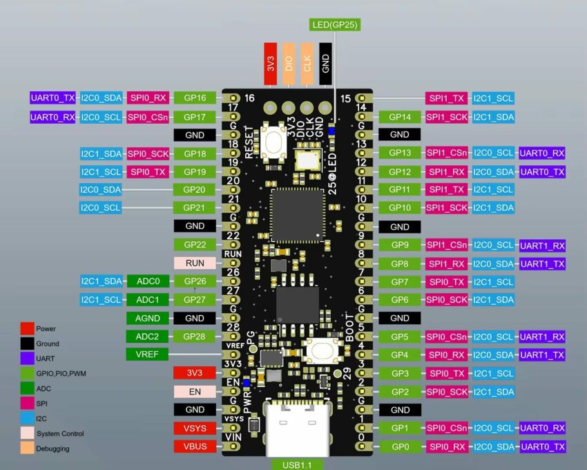

WeAct Studio RP2350A_V20 specifications:
  • SoC: Raspberry Pi RP2350A
  • CPU:
    • Dual-core ARM Cortex-M33 or Dual-core Hazard3 RISC-V processors @ 150 MHz
    • ARM TrustZone for Cortex-M with secure boot ROM
  • Memory: 520KB on-chip SRAM
  • Storage: 4MB or 16MB onboard QSPI flash
  • USB: USB Type-C 1.1 with host and device support for power and programming
  • Expansion:
    • 2x 20-pin headers (2.54mm pitch)
    • 26x GPIO, 3x PIO blocks, 12x PIO (Programmable IO) state machines
    • 3x ADC, 2x UART, 16x PWM channels
    • 2x SPI controllers, 2x I2C controllers
  • Debugging: SWD debug interface
  • Miscellaneous:
    • Boot and reset buttons
    • Power and user LEDs
  • Power Supply:
    • 1.8V to 5.5V DC (VSYS)
    • 3.3V DC (GPIO)
  • Dimensions: 51mm x 21mm x 17.78mm
