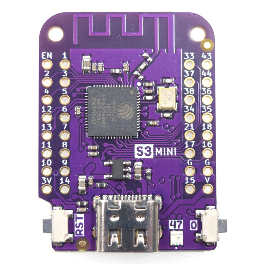

The LOLIN S3 mini is an ESP32-S3 WiFi and Bluetooth IoT development board to give a boost to tinyML workloads. Being the latest addition to Wemos’ LOLIN Mini Range, this new development board reverts to the compact design commitment of the company. At the heart of the LOLIN S3 Mini is a dual-core Tensilica Xtensa LX7 backing up to 240 MHz with vector instruction extension for accelerated machine learning processing.
The LOLIN S3 Mini comes with a static RAM (PSRAM) of 512 kB with room for another pseudo-static RAM (PSRAM) of 2MB. For connectivity, there’s a 2.4 GHz WiFi 4 and Bluetooth 5.0 LE with a maximum 2Mbps data rate and Bluetooth Mesh support.

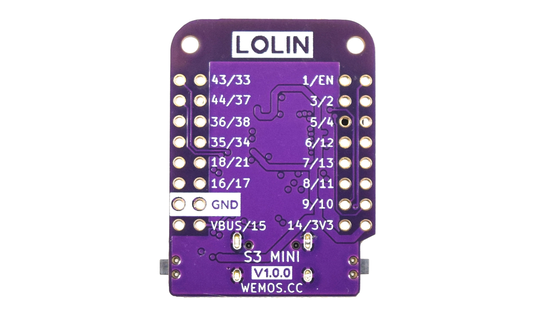

The development board allows up to 27 General Purpose Input/Output (GPIOs) coming with two 16-pin headers enabling attachment of ADC, DAC, I2C, SPI, UART, etc. Wemos also provides an RGB LED on this board, besides an input button. One can power it using a 5V voltage supply via the USB Type-C provided.

  • WiSoC – Espressif Systems ESP32-S3FH4R2:
    •  CPU – dual-core Tensilica LX7 @ up to 240 MHz with vector instructions for   AI acceleration
    • Memory – 512KB RAM, 2MB PSRAM
    • Storage – 4MB QSPI flash
    • Connectivity – 2.4 GHz WiFi 4 and Bluetooth 5.0 LE with support for long-range, up to 2Mbps data rate, mesh networking
  • Antenna- PCB antenna
  • USB – USB Type-C port for power and programming
  • Expansions – 2x 16-pin headers with up to 27x GPIOs, ADC, DAC, I2C, SPI, UART, USB OTG, etc…
  • Misc – 1x RGB LED (IO47), Reset button, user-programmable button (IO0)
  • Power Supply – 5V via USB Type-C port
  • Dimensions – 34.3 x 25.4mm
  • Weight – 3 grams
