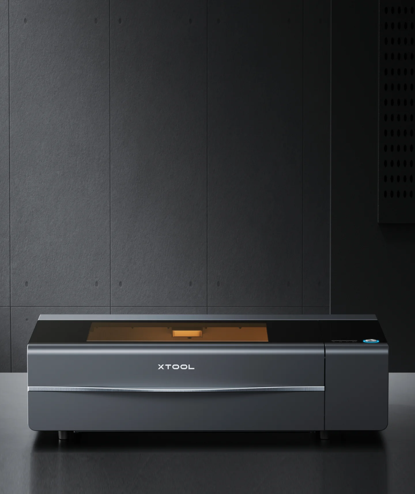

The xTool P2 is packed, and I mean it, when you look at a standard beginner-grade laser engraver, it will be shipped to you with an air assist, exhaust, and water chiller that you need to attach to run the CO2 laser properly, but the xTool P2 is all in one so it called a  “desktop” machine.  This beast weighs 99 pounds or 45Kgs and takes up 39.4 x 25.1 x 10.6 inches of counter space, so it will take up to two men to move that around.
Let’s look at some of the major features of this tool, the xTool P2 is a 55-watt CO2 Laser Cutter built for creating customized home decor and furniture or you can start a small business of yours as it has a calculated lifespan of 6000~8000h. It can cut 20mm transparent acrylic in one pass and features two built-in 16MP cameras to position drawings and patterns precisely. The first camera gives a wide view of the entire work area for easy positioning. The second camera provides a detailed view for precise engraving in specific areas. On top of that it can engrave on curved surfaces with automatic surface scanning and focal length adjustment. The enlarged bed size and new pass-through feature with a conveyor feeder allow for larger and longer projects. The tool can also be equipped with a Riser base that increases the inner height to 215mm, ideal for customizing items like suitcases. Finally, there is also an additional rotary engraving accessory available that works on tumblers, mugs, spheres, and rings. Unlike traditional CO2 laser cutters, this comes with a built-in air exhaust system, with a filter making it safe and easy to use indoors.

The engraver is fully enclosed and resembles a metal cabinet with a tinted glass top. on the right-hand side, you will find a switch and display, the display gives you access to progress bar temperature readings and a few other information. The lid features hydraulic hinges, making it effortless to open. Inside, the black-on-black interior is neatly organized, with the laser’s wiring securely housed within a robust cable chain.
The Xtool P2 laser only operates when the lid is locked, ensuring safety. The enclosed has air vents at the bottom, which are discreet but you should be careful because it’s big enough that your hand can get under the gap. It features two 16MP cameras for wide-angle and detailed positioning these cameras are responsible for the machine’s 0.3mm accuracy. The focus of this machine is very precise 0.01mm to be exact, this tiny beam delivers precise lines, and the 55W CO2 laser cuts and engraves faster than any other generic engravers out in the market. it also has a Built-in air assist to prevent charring and a powerful fan removes smoke via a hose or optional air purifier. The air purifier is effective but expensive; using an exterior vent may be more cost-effective.
The P2 requires a computer connection, ideally a laptop for the initial USB setup, after which it can connect via WiFi or Ethernet. A start button ensures the machine is not left unattended. It automatically focuses using the material height provided in the software or its cameras. The spacious interior is effective without optional accessories, though its large size can be cumbersome, occupying a 42-inch counter. For pass-through use, a sturdy, open table is needed, preferably in a garage. Access to all sides is necessary for plugs, hoses, and compartments. Key components include the power cord and switch at the back right, emergency button on the right, air duct and ports on the left, and optional fire safety kit connection behind. The CO2 tube at the back requires access only for cooling fluid checks.
